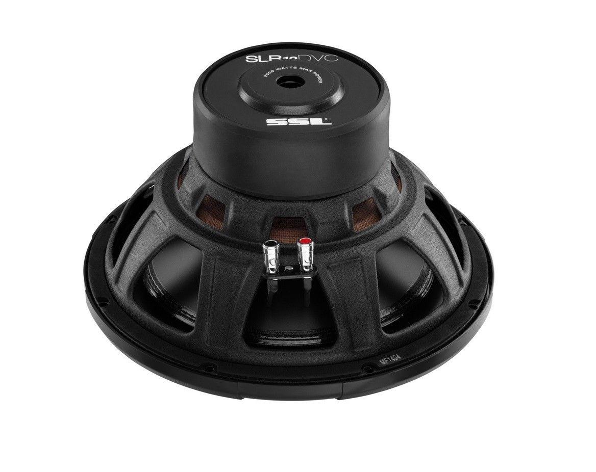

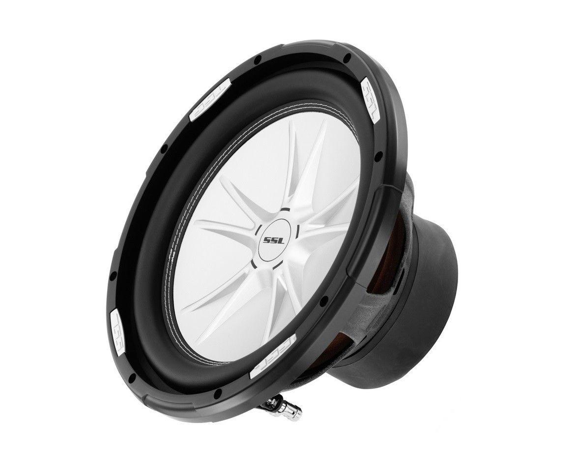

SOUNDSTORM (SSL) slr12dvc Кто нибудь знает что это за динамик?????
High Temperature Voice Coils
Butyl Rubber Surround
Subwoofer Size: 12"
Peak Power Handling: 2500 Watts
RMS Power Handling: 1250 Watts
Voice Coil Configuration: Dual
Impedance: 4-Ohm
Mounting Depth: 6.3125"
FS: 36 Hz
Qes: 0.96
Qms: 4.71
Qts: 0.81
Vas: 1.374 CuFt
Xmax (One-Way): 12 mm
Sensitivity (1W/1m): 85 dB
Recommended Sealed: 1 CuFt
Recommended Ported: 1.3 CuFt
Port Diameter: 4"
Port Length: 12"
Port Frequency: 45 Hz
Package contains 1 subwoofer
